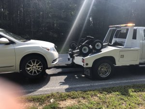

Now my car is a different story....it derated today!
Dang Corey...you’re just having all the luck.
