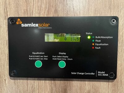

I have 4 roof mounted (tiltable) panels. Two 150 watt and two 200 watt so 700 watts total. I have one controller that is a Victron MPPT 100/30. I believe it is capable of handling Lithium. My coach runs on 50 Amps. Should I upgrade the controller to a Victron 100/50? The company that installed the two 200 watt panels for me installed the 100/30 controller without letting me know a 50 was available. And now I am confused. I also have a Samlex Solar SCC30AB mounted on a wall that came with the coach when I purchased it. It controlled the original two 150 watt panels. The coach came prewired for two sets of panels. Both are being used.
30 Amp Solar Charge Controller | SCC-30AB | Samlex America

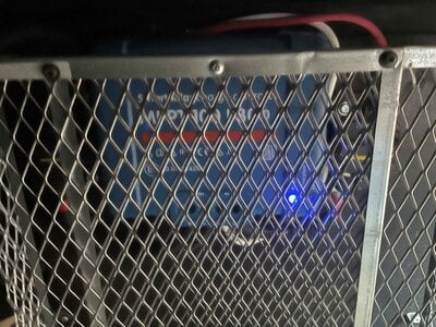

Surely I don't need two controllers do I? The one mounted on the wall gives me readings and the one mounter in the battery compartment is also lit up. See pics I built a cage for the Victron as it is mounted in the battery compartment. I also keep my leveling blocks in there so I just added some protection.
