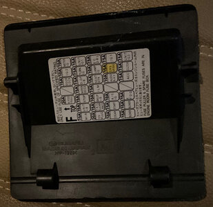

But a certain plastic door, that hides the fuse compartment, and has a guide to the fuses, will no longer stay closed. I've been storing the cover in the glove compartment, but it takes up too much room.
The cover's hinges are intact and are evidently designed so that you can remove the cover and see the fuse chart. I don't know what could have possibly broken off so that doesn't stay closed.
Does anyone have any ideas to secure this? I thought of Velcro but that's not my favorite idea. Whatever I use, it will probably need to be screwed on, because most adhesives can't withstand our extreme summer temperatures.
The first picture is the compartment in the second picture is the inside of the door, and they are both oriented in the same direction. You can see remnants of adhesive where I used duct tape in the past. (I have much higher resolution photos if necessary, but I don't think it would help.)

Hard to tell exactly but if you drilled holes in that guide area in the dash and installed some pan head Philips screws in those little nubs on the cover so they would engage into the drilled holes? would that be tight enough?
From your description it seems like the plastic attachment points are just worn out. A new cover would be the fix. Here’s just one example - I found many. OEM 2010-12 Subaru Dash Fuse Box Door Lid Black Outback Legacy NEW 66135AJ00AVH | eBay
I think I get what you're describing and that is a terrific idea. I'll try that if the new cover doesn't work out.

Its possible that the problem is with the molded part of the catch in the dash but it will be cheap to find out before trying other methods. Did you find one for sale with your exact part number?

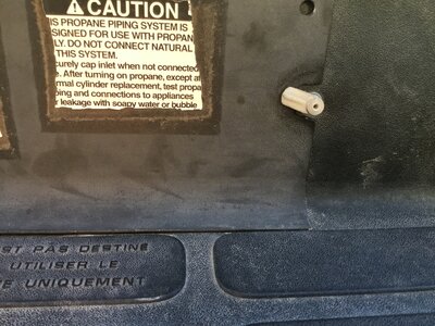

A small clip that turns, is what is used on the cover for the propane valve. Can be mounted with a screw.
I found one that looks exactly like the original, dunno if it's same part #. If it doesn't fit, I'll try the 'bumper' idea, and if that doesn't work, I'll head to Hobby Lobby.
That could work, but where could I find such a thing? in black, preferably. I'm thinking mirror clip now.
