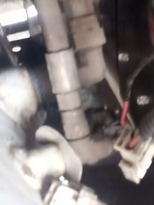

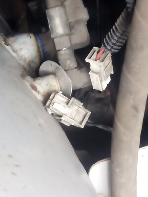

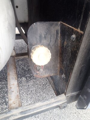

So there is supposed to be a full tank, it's a electronic valve and there's supposed to be a manual valve but can't be found As you can see in the photos it looks like the wiring for the valve cut off switch is disconnected and there is no gauge on the tank the closest thing is the readout and the control panel which we can't make sense out of. The propane when the gas range is used lights but goes out and the refrigerator when switched LP says FL no which means there's no propane. There are no places that do inspections of fixed tanks that we know of so this is something we either have to hire a RV repair who has experience with this or DIY for starters it seems like getting a analog gauge would be a good idea to determine just how much is in the tank if anything. Either the tank is full and there is an issue with the electronic valve or the tank is empty. One question needs to be asked is it safe to install the gauge on a tank that we know very little about.?

There has to be a manual shutoff so I would find that first. It should be near the fill point however your photos do not seem to indicate that. Possibly photos of the complete tank may help. The fact that you say the pilot does temporarily light could be residual in the line. One option that would not cost would be to take it and have it filled see if they tell you it is full. With no gauge it is hard to tell. I know this may not be of much help just some thoughts.

Do you have a picture of the front of the tank? What you see as you open the door.
That one picture with the cap on it that's where the tank is filled that is the front of the tank there is no visible manual valve to be found. Just a quick update based on my interpretation now of the indoor LED meter levels the tank is indeed full. The only thing I can conclude then is that there is or was residual gas in the lines that's why there's been very little available and no doubt due to the manual valve being closed propane is not being released. I'm going to see about getting some info from Holiday Rambler and see if they can shed some light on the subject.
I keep reviewing your post. I keep looking for useful photos, but haven't seen any.
To get involved in this one I would have to have blur free pictures that didn't give me a headache. I would need pictures without pipes and wires/connectors obscuring the components. I would need pictures showing the regulator and how it connects.
