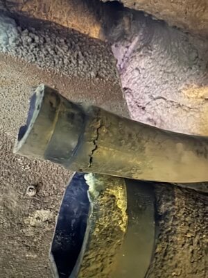

Still working on the fuel tank. I pulled the soft portion of the vent tube and was able to blow air both to the tank and towards the fill door/opening. I found some cracking in the tube right near the end that attaches to the hard section so I cut that off and reattached

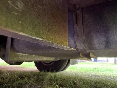

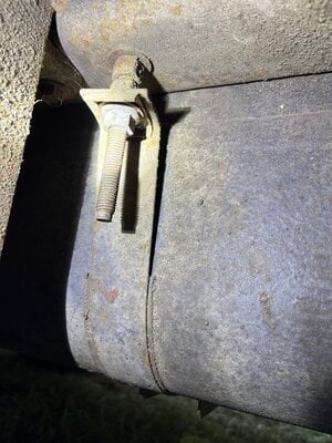

The latest thing I’m wondering about is IF the tank was out before could the tank height position be reinstalled to high? In this pic it almost looks like the tank is lower on the near side which is where the fill and vent tube attach. I also can see some shiny metal on the shroud in front of the gas tank. Maybe this can be lowered? Thank you for any help and thoughts 😁 IMG_2578.jpegIMG_2580.jpegIMG_2581.jpeg

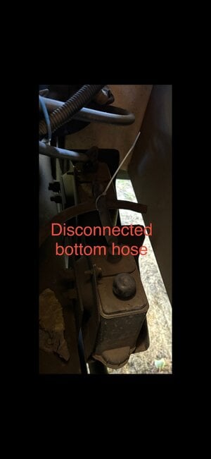

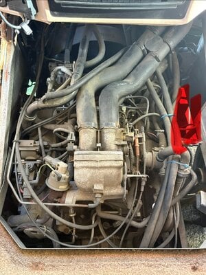

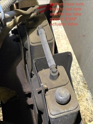

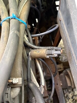

Located the charcoal canister…turns out there are two connected in series?. I looked over the entire frame front to back with internet searches saying it would be towards the rear/fuel tank. Nope. Oh well. Passenger side frame rail near engine and could see once the engine cover was removed…see red highlights and pics with a hose I am going to try fueling with disconnected tomorrow. Fingers crossed. Suggestions/comments always appreciated. IMG_2601.jpegIMG_2604.jpegIMG_2602.jpegIMG_2599.jpeg
The day started off with yet another disappointment at the gas station. 😔 Disconnecting the vent line at the EVAP canister did not solve my problem

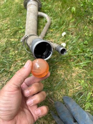

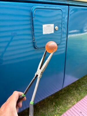

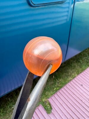

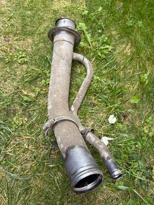

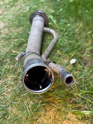

I returned home ready to call the RV Service place near me and make an appt ie give up on trying myself anymore. Well for some reason I kept thinking about the main fill tube and the odd black plastic 3 prong thing that is press fit into the metal section about 12” down from the gas cap…it looked like it was missing a part but no signs of broke off edges. Anyway, I kept searching the internet for anything about anti siphon parts but none of the images looked like what I had plus the few searches suggested that F53 stripped chassis would rely on the motorhome to “plumb” the final fill and vent. I decided to pull the fill and vent apart one more time and make sure nothing was way down in there near the opening to the fuel tank….well after poking around carefully with several picks and things I removed something that looks like a kids super ball!! See pics I’m thinking this check ball is supposed to be held in the fill tube by the 3 pronged black plastic thing that I kept thinking about. Back to the gas station and problem solved as I filled the tank at full speed with no hint of clicking off or spitting gas back. Sooo pleased and wanted to share for the next guy like me very frustrated with 30 minute fill ups It was never a venting or ptrap thing after all 🤷‍♂️Fingers crossed never again!!
PS I did not reinstall that ball but keeping it on IMG_2605.jpegIMG_2608.jpegIMG_2606.jpegmy workbench as a sort of trophy for all this problem solving. Thank you to all who helped along the wayIMG_2609.jpegIMG_2607.jpeg
