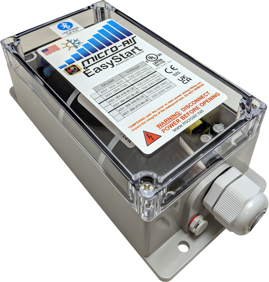

For soft start recommendations I recommend Micro Air:
That was one of the units I was considering just based on other posts. Does that mount up inside the unit? or does it get wired inline between the RV and the unit power feed?
