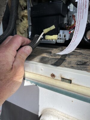

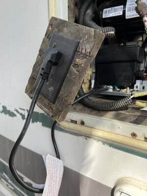

Plugged in a brand new Dometic 2672. No power. There Is power to outlet, and power going in to the fridge. Fridge fuse fine.
Does DC need to be hooked up, too?
Was going to hook the black and white to the 12v input on the fridge, but DC is usually black and red. Any thoughts?

Yes, it runs on 12v dc. 120 ac just does the work. Use a multimeter to determine positive and negative on the 12 vdc. You cannot trust common sense with camper wiring.
Thanks. I’ll try that.
