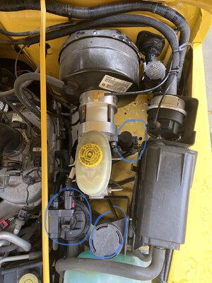

The first step is to determine compatibility. Then its important to confirm exactly how much work is involved in installation and how much modification is involved to make sure this is the right system for you.
I installed this on a 2001 Jeep which is a fairly simple vehicle. Even though there is a lot of room around the master cylinder, there wasn't enough in front of it, so I had to relocate the three components circled in the picture as they were all directly in front of the master cylinder, which has to move forward about 4.5”.

If the original system doesn't fit your vehicle, they offer a “2.0” system which probably does, however I have no experience with it and looking at the design, I would probably pass on it in favor of a conventional “brake buddy” type system.
