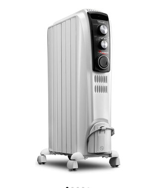

Now, I don’t live way up north, but it you only going to be there for a week or two I would drain your fresh water tank, drain your lines opening each faucet, toilet, etc. then blow the lines with air opening each fixture one at a time. Then I would get a small heater for your wet bay and an oil type space heater for the living area. Try and keep it just above freezing. Oh and open your cabinets.
I have a similar oil heater and use it when traveling to keep from using the propane heater. Works well.
