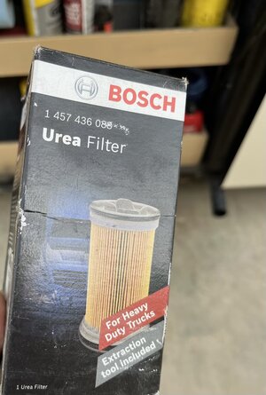

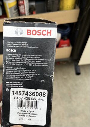

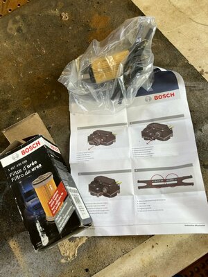

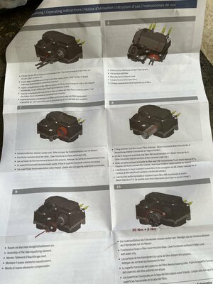

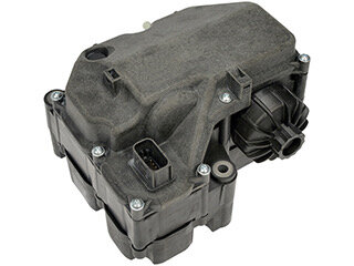

Rich, I have a 2017 Ventana 4369, where is the filter located and what does it look like?
If its Freightliner, and maybe also for Spartan, the filter is located on the pump, behind the round cap on the center/right side of the pic. The pump (called a DEF Supply Module) is usually located at the bottom rear of the tank (facing the filler neck). The filter is available for around $60 if it says Bosch on the box, or around twice that if says Cummins (also Bosch). Having already experienced a pump failure, I carry a spare. Here’s a link showing a Bosch filter for about half price:
Your part# may be different of course.

Thanks, I should have identified that it's a Freightliner chassis.
As a disclaimer I haven't read anywhere that anyone agrees with my findings, or is proposing annual filter changes, unless you drive 100,000 miles/year.
But I had a pump fail on a rig that was only four years old and only had 26k on it at the time. It was still under the emissions warranty which was nice financially, but that didnt keep me from having to return home, cancell all my Christmas/New Years holiiday travel with family, and wait over a month for an appointment at Freightliner.
So this is all school of hard knocks stuff and not research or the advice of techs or the result of a seminar or whatever. But I figure for the cost it’s cheap insurance and my passion about these emissions systems starts and stops with avoiding ever being stranded by the complexity and fragility of them again.
Do you change it on an empty tank? Or it does not matter?
I was going to ask FL at Gaffney to do it.
Doesnt matter if there’s DEF in the tank - the filter housing should be dry when its not running. But having FL do it is probably a good call because its such a quick easy job they probably only charge a 1/4 hour for it, and it keeps you from crawling under rig.
