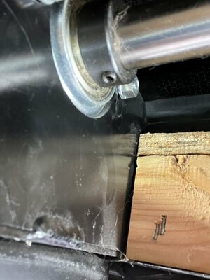

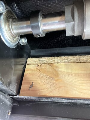

its also a good reason to get in there and poke around and make sure everything else is on order. Thats how I found the damage in post #7 and the loose collars in post #11.
Chief, I not sure what I am looking at in post #7. I have found small shavings and burrs when the kitchen slides move back and forth, just figured it was from mfg.
