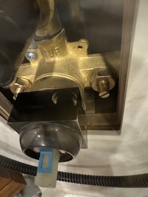

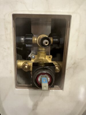

I'm getting around late this spring flushing the antifreeze out of my Newmar Dutch Star 4310. I have discovered that there is very little pressure from the hot side in my master shower. The hot water pressure in all other faucets is fine. Im curious on how to access the mixing valve as I have guessed this may be my problem. A little history we purchased this motorhome used last fall and had no opportunity to take it out before now. Any help would be greatly appreciated. Thank you
Ok so I have access now but I can't figure out how to remove the cartridge or this black piece of decorative trim.
Any ideas or suggestions would be greatly appreciated. Thank you
I replaced my faucet soon after buying it, so that may be your best option. Do you have the water miser?
Well I’m not sure about the miser. I did finally figure out how to remove the cartridge from the valve body and ordered it from Newmar. They acted like it was most likely the problem and I’m sure hoping that is right. How would I go about finding out if the water miser exists on this coach?

You would know….as it is the function in the shower that recycles water back to the tank to save water while waiting for the hot water to arrive.
And it very well could be the cartridge as they can get gunked up from hard water and minerals.
