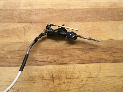

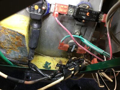

What about the electrical connections to the heater elements where the wiring enters the top of the Oasis? These hav been know to burn out…
