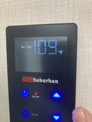

Our water heater has a digital control to set the desired temperature.In the summer we find 106-109 degrees is plenty.We set our temp then turn all hot water on, occasionally adding just a little bit of cold if it gets to hot.Seems to me the newer water heaters have very sensitive pressure flow control switch’s which I believe are for scalding safety as my 6 year old tankless in my older RV works much better at regulating temps.I totally agree these water heaters are not best for boon docking.
