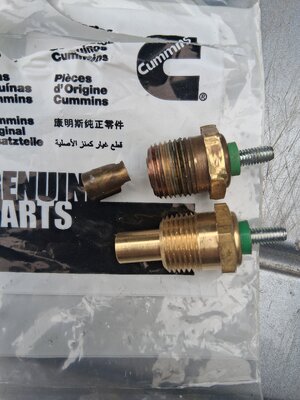

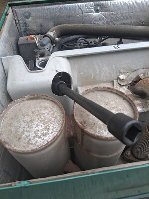

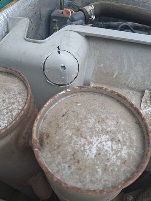

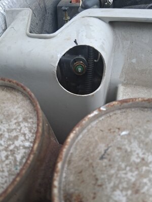

Got the generator out of the MH. I used an ATV jack. I pulled the coach's front wheels up on double 2x12s (which gave me room to work a little more comfortably)and disconnected all the bolts and fittings before lowering the jack. I then raised the front end up using the camper's hydraulic jacks with a good base of sturdy 6x6s under each jack. This took the guess work out of how high I needed to go to get the proper clearance to roll the generator out. I tested the coolant sensor and got 11 ohms which validated that this was most likely the issue. I believe it should test out in the 60-70 ohm range? I ordered one online and waiting for delivery. I drilled a 2 inch hole in the fiberglass heat shield to allow for a 19mm 6 point socket to come in at the proper angle. I rocked the sensor slightly clockwise and CCW with a breakerbar. It was freeing up so I turned it all the way out but the non threaded end of the sensor, which encapsulates a spring, broke off inside the housing. Luckily I was able to extract it by working it with a 25/64 drill bit. It's brass (or copper) and soft. Before that I pulled the thermostat housing and thermostat and packed the throat with a rag in case any of the shavings entered that area. I got chased inside by the rain. When the sensor comes in, and the rain stops, I'll post some pictures of the reassembly.

Attaching some photos of my repair. Index mark with sharpie for reinstall. Drill slowly to not melt the fiberglass.

New sensor about $80 w/tx & shipping. Suggest jamming a rag between engine and housing. I dropped 2 things which took a wire coat hanger and alot of patience to fish out. There was a buildup of what appeared to be crystallized coolant in the sensor housing. I used a 1/2 inch plumbing bru
