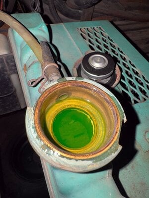

Here is a picture of what the coolant level should look like when removed cold.
Notice the level is even with the overflow tube. Keeping air out of the system keeps oxygen from getting to the metal parts to keep the components from rusting.
Notice also I have added a tiny hose clamp to the system’s recovery hose. This is where most coolant recovery systems leak. If there is a leak with the recovery hose the system will pull in air and not coolant from the recovery bottle.

It makes no difference if is a water-cooled internal combustion engine, the radiator should be full when cold. Here is my generator. Please note I added another piece of tubing to achieve a tighter fit so the recovery system does not leak.
