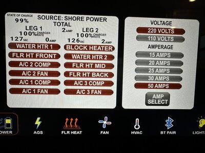

In a split phase system (50 a) circuit loads should be balanced based on your utilization. The manufacturer guesses at how you will use the RV. If the loads are not balanced, and everything is on one leg, you then find yourself in a situation where you cannot run something because one leg is maxed out and another leg is under utilized.
When a large coach is running on battery and has dual inverters, this is even more critical. But it is possible to add load balancing devices so that each inverter is carrying an equal load - this was an option installed on our SuperC, and it is very nice. Don’t have to worry about running oasis fans, microwave, coffee maker, lights, fridge, etc.
