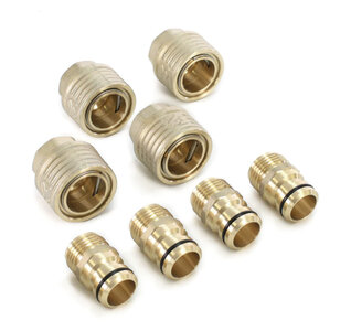

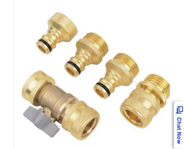

There are a couple different types of quick connects, some of them severely reduce the size of tube while others are almost unrestricted.
