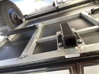

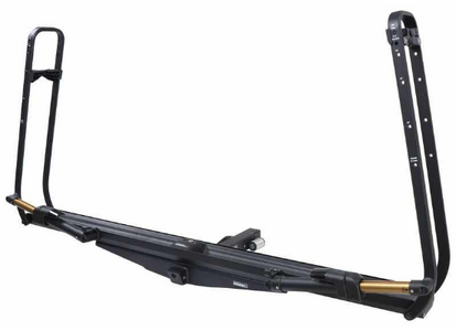

I have a 2025 Flyer Pursue. I'm concerned about the rear receiver hitch being bolted to the frame. Looks like it's only an unreinforced short straight shank or whatever it's called. Would like to put on a E-Bike carrier and an E-Bike on the back of the RV. It's about 125 more or less total pounds of weight.
Question here is it stable and safe to do so on this bolted on? Anyone done any reinforcement modification? Factory support wasn't much help but telling me not to drill holes in the frame. So I'm open for any eyedias that would give me more peace in my mind.

I have seen some re-enforcement done by attaching two ratchet straps just to the bumper. Haven’t tried it myself but I’ll be watching any replies you may get.
It says the receiver is rated to 175lbs. You may want to secure the carrier in the receiver with an anti-rattle stabilizer ( $15-20.00 on Amazon). Make sure the bike carrier is RV rated, they’re a bit stouter built to handle the increased dynamic back there.

There is no way I would put any weight on that, 4 bolts?

Thank you for replying. Have no bumper in the back.
I agreed and I do use the anti rattle stabilizer on my ball hitch if you meant that U-Bolt with a flat plate (lil curved on 1 side). Was advised by the factory NOT to modify back there so I was like hmm? I'm under 175 on the weight so should be good with attached safety cable/chained to the undercarriage for peace of mind lol. Aiy Aiy..I need another bike after dragged. Thank you for replying and here's your beer back.

I have a Dusk model. Would not recommend putting that much weight there. Not only the bolts, but aluminum welds may not be able to hold that much weight bouncing up and down. I use that hitch for aluminum cargo basket from H Freight for lighter bulky items only.
The tag says 175lbs (max) so you are well within limits. If you get (have) a sturdy e-bike rack and use a hitch connection tightener (to limit bounce) you should be fine. Plus, perhaps you can devise so strapping to lessen bounce even more. JMHO...Blessings
