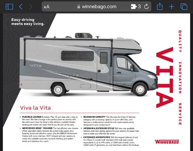

Per the Winnebago, it came with a 1,000 watt inverter from the factory...
OK that's likely the problem. Even the smallest of refrigerators would have a hard time starting reliably on 1000 watts. I doubt the refrigerator is on the inverter circuit.
