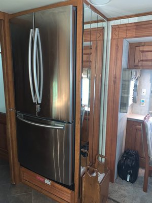

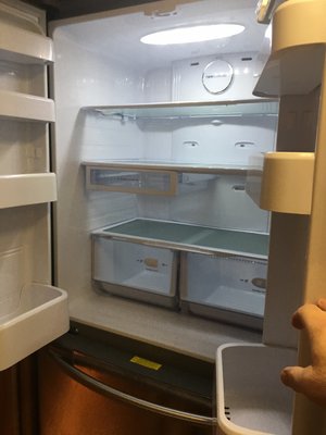

I installed a Samsung 18 cf stainless steel french door bottom freezer 'fridge in my motorhome a couple years ago. It's the best thing we've done so far!
