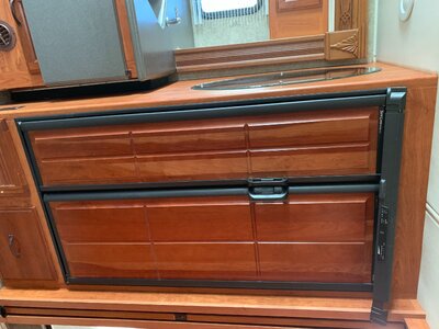

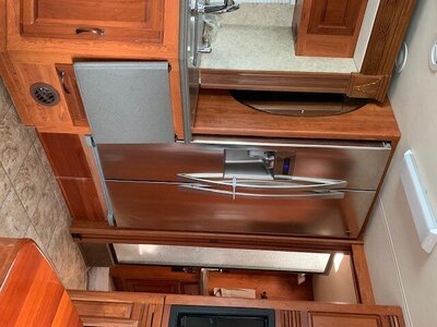

Our RV fridge went bad and I replaced with a residential fridge. Reasoning I could get a 24 cubic foot resi fridge in the same spot my 12 cubic foot fridge fit. I could block off the roof vent and side vents on the rig sealing it up better. The temperature control is much better. (My wife likes her ice cream frozen). We boondock and with the Kenmore Elite fridge and with our basement dorm room type fridge 1.7 cubic foot and misc 12vdc items powered I draw 1-2 amps. We have (4) AGM house batteries and can run 14 hours without needing to charge.
I have no idea why these pictures are the wrong rotation. These typically load in the correct orientation.
