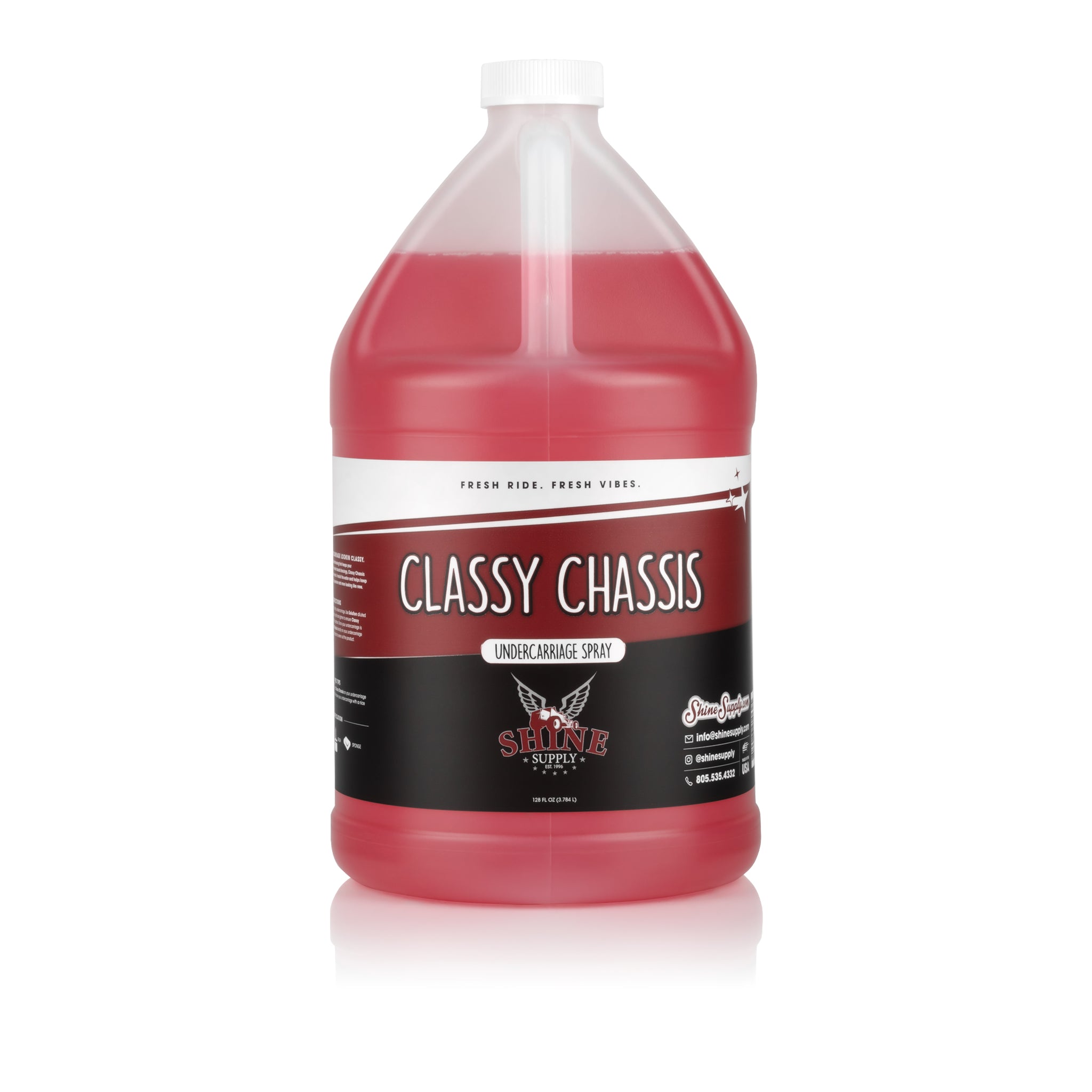

For under body / chassis / engine / hinges I use a gallon size garden sprayer and coat every square inch with this product:

Classy Chassis is going to do several things:
#1 - It is going to attach itself to the metal. It will move dirt and other pollutants out of its way, moving it to the surface. It will not move rust, but it will move grease, caked on dirt, etc.
This is why you start with a clean surface. You don't want to use up the product to do the cleaning for you.
#2 - It is a barrier against anything attaching to the surface. Once dry you can test spray painting it, you will find that the paint does not attach (tested on small test area). Salt and other chemicals do the same. Water will not remove this product.
The product can become overwhelmed with dirt removal, and eventually is no longer effective. That is why we are doing 3 coats. 3 coats will last for several months of nasty weather driving. My daughter lives in Chicago area, and we treat her jeep in November, and clean up in March, and its perfect.
To remove the product, I use an all purpose cleaner from Shine Supply mixed at 4:1 (Solution - Gallon)
BTW---Solution is the best cleaner. I will talk more about that later.
For an RV -- you want 4 gallons of Classy Chassis. You will have plenty to treat your toad too. This will last one season...or if you are really picky, One trip in the winter driving conditions.
