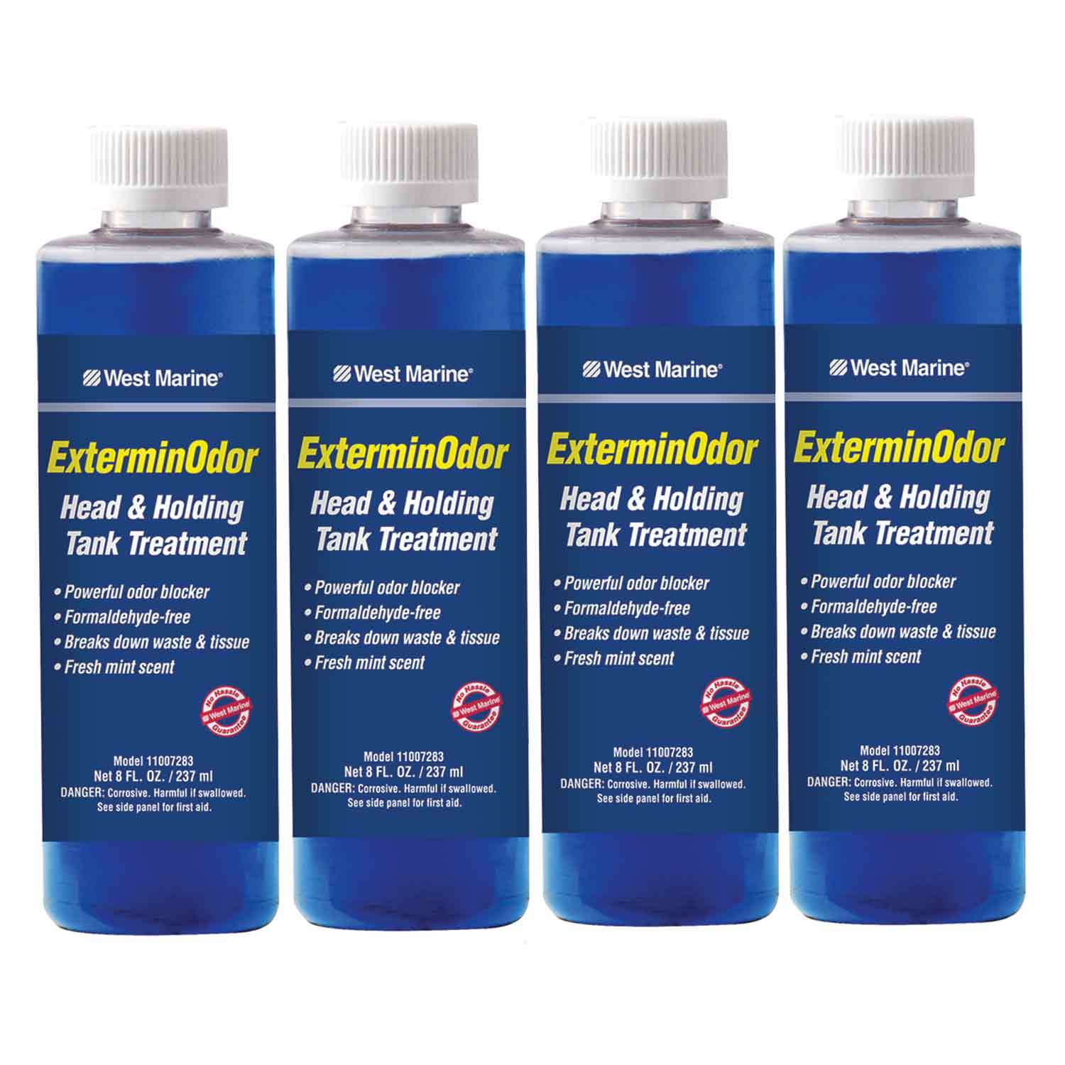

This is also why I am a firm believer in using the West Marine ExterminOdor tank treatment EVERY time I have water in my waste tank…which is all the time. I purposely keep around 10% during storage, with a healthy dose of treatment because the stuff actually smells GOOD and always punches through any odor no matter what.
You have to get it direct from them, so here’s the link if you want it:
I don't use tank treatments, my opinion is they're gimmicks, that's just me. At times I'll put liquid cascade in the tanks and let them soak near full to give them a good cleaning. Otherwise the odor issue is as mentioned, dry p-traps. If you have a washing machine, it could be there too, anything that has plumbing try to keep cycled.
Neal, I think we agree…in terms of “what” they do to solids. I’ve watched all the dog food tests…🤪…and not sure there’s a “clear” winner! 😉
I used to use the enzyme called DigestIt. Didn’t feel it did what I want, which was deodorize. Then, my sailboat racing buddy turned me onto the west Marine stuff. He said there are two things a pro sail-racer knows how to handle…batteries and waste management! Lol
So, with that…he’s right. The stuff smells SO good, I actually like the smell that it produces even when my coach is coiled up in the bay on a nice, toasty, 110° day.
