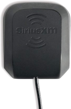

Multiple locations now I've been getting intermittent reception from SiriusXM. The antenna is on the roof, it should be ideal, but something has not been reliable. I also have been concerned with the black plastic unit sitting on the roof in direct sun like it is and wondered when it would deteriorate and have an issue. While it looks fine, I'm not sure what the problem may be.
I ordered a replacement antenna and mounted it under the dash which is also where the NAV antenna is for the dash navigation/radio. Under dash mounts are typically fine for satellite reception. So far it is working well but time will tell as 90% of the time the roof antenna worked. We'll see how this works out.
To replace is easy. The SiriusXM tuner is located behind your dash radio in a cable tied bundle. The roof antenna plugs into that unit so changing it out is simple.
