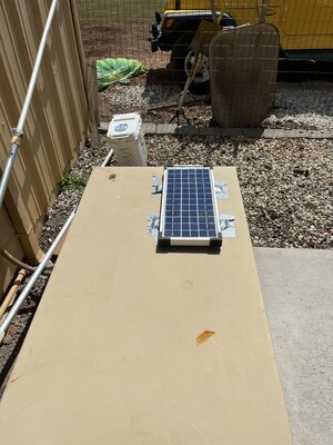

This one actually came off my Ventana. Not sure what happened to the one that came off the bay star. The last two times I needed this generator I had to jump start it. Now it fires up without hesitation. Not a particularly elegant installation, but it works.
