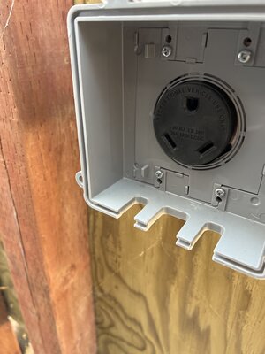

Yesterday morning while running the microwave, power cut off to everything. The whole kit and kabootle. I plugged the RV chord in to a stand alone generator, and power came up fine to everything. So, I have to assume the issue is with the solar system.

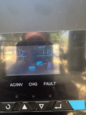

The system checks out for charging and operation, except it’s showing only @60v at the 30a RV plug in.

Can outlets get blown while still looking fine? Is it possible the problem is just the outlet?

That’s the set up. It’s ac at the plug (obviously). Inside, the converter supplies the 12v dc where needed.

So the picture says 119v, but the receptacle says 60 v? Check the terminals for proper torque. 60 v is a big question for me.
I'm hung up on that voltage, yes bad connection is likely the problem.
