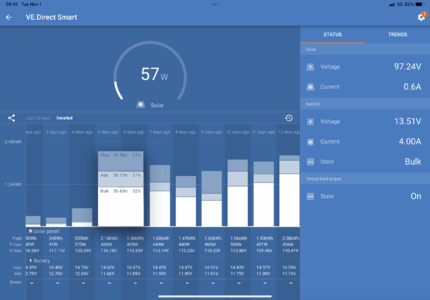

If you buy a Victron controller, consider one of these as well: VE.Direct Bluetooth Smart dongle - Victron Energy . That way you can easily monitor your enertgy production from your smart device.
Or lack of production if you’re in Humbolt County during a rain storm…. 602D10A5-EB16-4124-846D-09E59A404107.png

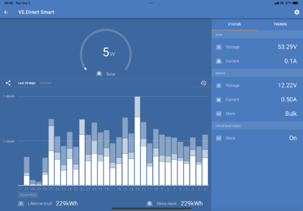

You can also get more detailed info:
There’s blue sky on the horizon but for now heavy cloud cover so for the first time on this trip I’m running the generator. If and when I upgrade my battery bank, I won’t need the genny nearly as often.
