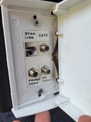

Updated the junction box in our cord reel bay. We had opted for additional coax runs for a carryout DISH antenna, which I actually used for our Weboost. We used CATV at some parks...which was usually not great. With our LG TV, we prefer streaming...and Starlink has been great for that. So, I figured I'd see if this is going to work. The Router & Power Supply are clipped into an aftermarket mounting device up between the frame rails in our half bay. I ran a short Cat6 over to the cord reel bay, and added the Keystone Shielded RJ45 jack. Now when we deploy Starlink...I'll just route the cable down the Flagpole buddy and potentially under the coach to the cord reel bay and plug-in there. I'm hoping the shielded cable won't have any significant signal disturbance from the power cord...so, that will be my first concern to address when we resubscribe later this month.

I was reluctant to use a regular RJ45 connection on the dish. Starlink went to some trouble to make it seal...so, I purchased an aftermarket Starlink cable.
They had them marked down on Prime Day. So I plugged one end into my Starlink Router which is in the half bay between the rails...there is a 110 outlet in that compartment too. The cable goes over to the CATV box where I terminated it with a shielded keystone jack. I cut the cable there...and the other side of the cut crimped on a Cat6 shielded RJ45 plug. Of course silly me...ordered one that would be good for 23awg wire. 26awg wires shifts around too much inside the connector...it took me 7 trys to get one to work properly. I'll know better next time.
If you do make new connections...it sure is handy to have one of those cheap testers.
Now I'm running WAN cable from the Starlink router up into the kitchen SO and over to where the Televator is…for cabled connection to Pepwave. We've had our Pepwave sitting on the dinette table for way too long. It will now sit next to the Televator.
Anyway...I tried to make the outdoor cable very easy to deploy and in a fashion where water intrusion would be mitigated.
