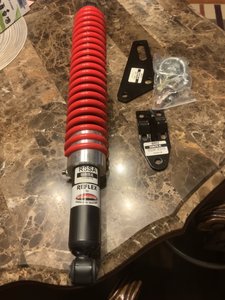

Getting ready to install a RoadMaster. Heard there good, we will see. :)
I have a "Saf-T-Plus" on mine, and it made a big difference in steering improvement!
Wish the same for you!
Good Luck!
Yes it did. It worked out very well. I am no longer having to work at keeping for going all over the place. Much more pleasurable to drive!

Did you install it yourself? If so how difficult was it? Any special tools needed?
It was not hard at all. It took about 30 min to actually do the job after gettin my tools and raising the coach with the front levelers. The only grunt part is to get the 2 nuts off the right back bracket that holds the front Axle on. I prepped by spraying PB Blaster on the nuts/the ads and cleaned with a wire brush and sprayed again. I broke them loose with a 1/2 breaker bar with handle extension “pipe”. Then used my 1/2 battery impact wrench. There is a video on install for it too on YouTube.
Now I have been turning wrenches most my life so easy for me maybe subjective, but easy to get to, 2 nuts to remove, install one bracket, and tighten 6 nuts. All easy reach.
