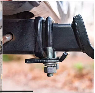

Can you attach a picture of how you have the U clamps connected? You should use 2. One from the car hitch to the adapter and one from the adapter your bike rack.
Below is a pic on how to use the clamps.
