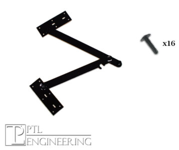

Couple of items worth sharing. The other day my Front Door POS-I-LOC HINGE Stop broke at the rivet. This was a common problem on my previous coach (Monaco) and after some years someone engineered a brass sleeved rivet that prevented this failure, perhaps someone will do same for a Newmar Locking Doorstop. Anyway while researching replacements, I was shocked to see Newmar Price @ $315 for such a simple steel part with same weak rivet (ComNet part # 09402). However they do also offer just the rivet for $13.49 (ComNet part # 015403) so I ordered one of these instead. Unsure if I'll be successful but will hopefully provide me capability to repair old one. Then I located the original manufacturer: PTL mfg. and sourced a full hinge for about 1/3rd the Newmar list price @ $119.76 Locking Door Check Kit . Once the new one arrives, I will attempt to rebuild the old one and have a spare (something I learned to do with my Monaco because they always fail at the worst time.
