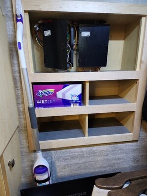

Upon further inspection, I think they might have not been done working on the lights. I found the KIB cover on the floor of the closet (not screwed in) and one of the KIB boxes open and not closed. I suspect they started work, got interrupted, and....

So I had the supposed firmware update applied to my KIB units by the service department while having other work done on my coach. After service my 5th KIB in the back bedroom closet was bricked (the communication bus LED stays on and doesn't flicker). This means my reading lights over the theater seats and the sconces on the bedroom wall slide don't work at all now. Oh, and my block heater outlet is now "on" when off and "off" when on almost like the NC and NO relay contacts are reversed. Of course the claim was this was a coincidence (yeah, right...) and they eventually ordered a replacement KIB. Ugh... I'm a pretty technical computer guy. How do mere mortals deal with these electronics issues?
What I'm most frustrated by is KIB dealer services techs. It took forever for KIB to respond to the service techs and even the Newmar royalty from the mothership that was visiting the dealership for our Newmar Academy class. I watched them call KIB 3-5 times a day, each time being told they'd call them right back, just to have somebody only play brail with them by texting back and forth vs. actually talking on the phone. At least SilverLeaf customer service was very responsive and helpful. I get why Newmar wanted to go with KIB vs. SilverLeaf (saves 2 out of 3 wires going to every control pad), but...
