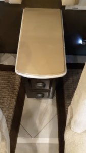

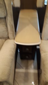

We have the 2 recliners. The table between them (in the 2016 model) is 26 inches long. The 2017's and newer are approximately 36 inches long not counting the slide out portion. Being longer makes them so much more usable. Especially if you have replaced the recliners with deeper ones.
I contacted Newmar parts inquiring how much a longer table would cost. Have not received a price yet. According to the parts person, the table is not listed as a whole unit but only as pieces to make one. He said it would take some time to work up a quote. I expect it to be pricey.
I'll start looking at cabinet shops as a possible alternative. May have to buy the top from Newmar to get a match. The wood parts, for the most part, are not visible due to the larger recliner so matching is not as critical. I'll reuse the handles.
Any other ideas or suggestions?

Thanks to all. I contacted WooddesignRV. According to Kevin, sales manager, the Corian color I have was discontinued 4-5 years ago. May have to go with a different color.
Haven't heard from Newmar. They may have some. Contacted them on the 25th. I'll give them another week.
My 2017 DS 4018 had that cabinet with the extending shelf. They did away with the shelf on the 18’s and 19’s. It was real handy, and with that gone, we went with the theater seats on our 2020. Same price as the recliners, but they stay in one place and add two seat belts.
Received a reply from Newmar. "The center table will take about 4 weeks to build and runs in the neighborhood of $925 to $1100"
I asked the price for the longer top only. $230.00. Since I can use the same drawers and hardware no sense paying for new ones.
Still trying to decide if I will have a local cabinet shop make a new base or just move the old base out from the wall with the new top.
As mentioned before, don't think it will be too noticeable. Especially since we replace the Euro recliners with Lazy Boys.
Thanks to all for your input and suggestions.
Received the new top yesterday. Very well package. They used expanding foam. Not the easiest to unpack but well protected. Color matches the old one
On the backside of the new shelf written with a marker it says 2018 DS.

Pictures?
Sent from my iPad using Tapatalk
