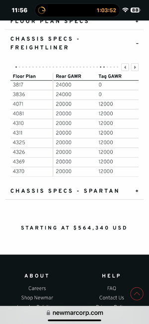

There are 2 types of steerable tag axles. The active steer tags operate with the driver input thru the steering wheel. The active steer tags do make a considerable difference in rotating the coach and in their turning radius.
The passive steer tags, which is what you would find with the spartan and freightliner chassis, do not steer with the steering wheel input from the driver. They are designed to just follow the turning of the coach. Their main purpose was to reduce tire scrub. It was originally designed for delivery trucks driving within narrow city blocks.
A passive steer tag may help the turning radius if it was compared to the same exact chassis with a solid tag axle which was not lifted or the tag air bags not dumped. In that scenario, a passive steer tag should help 'some' with a full lock turning radius, in comparison.
I don't believe allegro has comfortdrive(?). I suspect, the comfort drive(CD) may be a considerable difference for your driving experience.
Having a tandem axle (drive axle+tagaxle) in the rear does help the coach to track more stable and straight. However, in the same token, a proper alignment become seven more critical.
In 'general', recognizing misalignments with units that are equipped with CD, can some times be challenging. The CD does not differentiate between a cross wind, the crown on the road nor with misalignments, in general.
One way to inspect for any potential misalignment is to disconnect the CD. Then drive the coach on a relatively flat smooth straight road at close to hwy speeds. If there are any misalignments, it will showup.

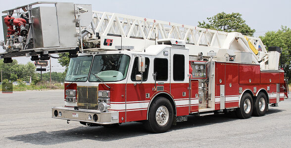

Thanks Rich. How do you like Newmar?Never drove a coach with a tag, but I spent a lot of time driving 10 wheel ladder trucks and water tenders, and I know enough about tags to be a bit jelly of anyone with one. Especially with passive steer…
