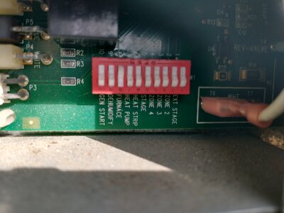

I stalled a new front ac unit and made a notation of the micro switches settings. The rear ac had been replaced before I purchased the RV without me realizing it. I can only get the thermostat to recognize the two ac units and not the furnace. Since the rear ac was switched out, I do not know if those micro switches are set up properly. Attached is a picture of the front ac micro switches with only the furnace switch #8 in the on position a believe. I am familiar with programing the thermostat but am not sure about the micro switches. Thanks for your help.
