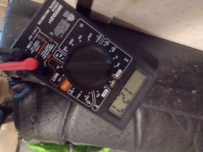

if i used the multimeter correctly this is the reading it gives me. i have an em830 digital multimeter
switch the meter over to DC volts and put it on 20, and see what you get.

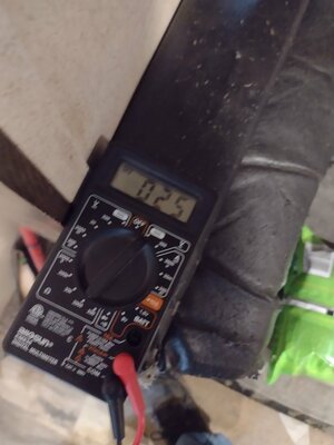

after some research on how to use this multimeter i realized i had the wrong setting i think i got the right one now. sorry about that, when turned down to 20 it reads 12.90 (pic below is 200)
So since you have power, its probably time for a new thermostat. Those t-stats are prone to failure anyway and they are cheap. But first, check your manual for a “factory re-set” option and if its is possible, try that before continuing. Chances are l just tell you to have it serviced by a qualified technician.
You might be able to find the specs for bench testing a 3-wire RV t-stat, but its probably not worth the effort.
You might also research compatible thermostats that are more reliable. The CT (capacitive touch) design is kind of dumb for an RV and the cause for most of these failures.
So since you have power, its probably time for a new thermostat. Those t-stats are prone to failure anyway and they are cheap. You might be able to find the specs for bench testing a 3-wire RV t-stat, but its probably not worth the effort.
