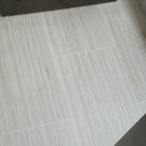

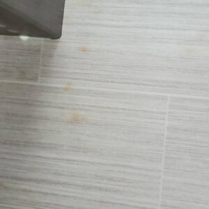

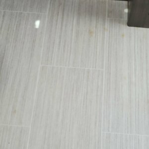

I have a 9 month old class c that has yellowing throughout the vinyl floors. Dealer is filing a warranty claim as it appears the glue used is leaching thru.
Has anyone else experienced this and if floors replaced how did it turn out?

My wife looked at it and said to try goo gone on the spots. She is thinking it if it was something oily then the goo gone could take it out. Put it on, let it set for a few min then terry cloth to rub it off.
At first we thought we spilled something and tried cleaning to no avail. Then we took up the runner rug and the floor is covered in spots from entrance back to the bath. When we took it to the dealer they did not even balk and said without pushback that this is an ongoing issue related to a different adhesive that was used. It appears we have no choice but to go with the warranty claim and hope it turns out acceptable. Looking to connect with folks with the same issue and find out how the repair turned out. It's about 60 hours of labor so we also wonder how long they will have the coach out of use when the time comes.
