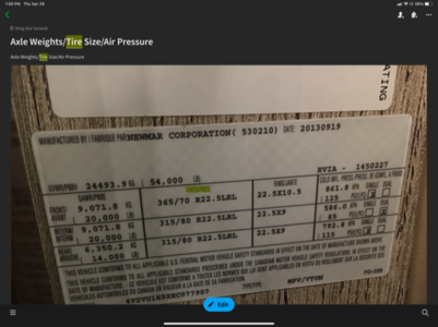

There is a metal small plaque usually on the drivers side that shows the weight and pressure on the original tires from Newmar.
