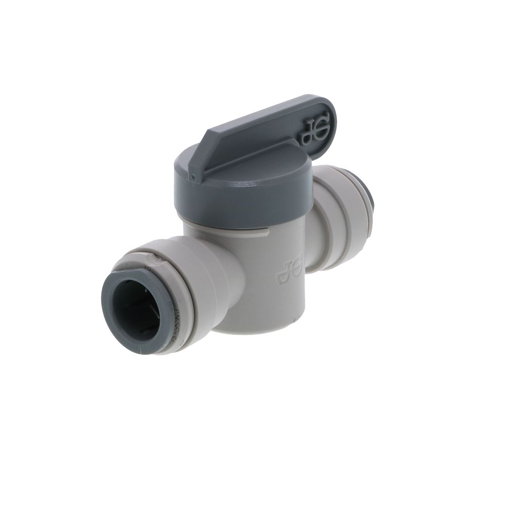

The valve below is similar to what I used on ours. Just cut 3/4 inch or so from the existing line and insert the valve. You line is shorter than ours so not sure it would fit. Could be possible below the floor as well.
