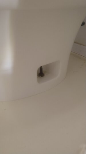

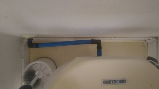

I'm fairly sure it's PEX now that I took a good look. Attached is picture. So if I remove the 2 anchor bolts on either side I can lift out the complete toilet? It looks like I gotta somehow disconnect the PEX first then anchor bolts? I do not see a valve at all.
Yes PEX!
Yes the studs hold the toilet down!
Don't forget the new foam gasket for the toilet.
If you use a hose, then you can just cut the PEX when you take things apart. Then again you could use your phone camera and see what you need to unscrew.

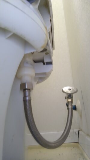

Cut the pex, install a 1/2 inch pex to 1/2 male pipe thread 1/4 turn ball valve. Then get a standard 1/2 male pipe thread to 1/2 male pipe thread stainless line, available anywhere in the length needed so you dont have a bunch to curl up and don't have to bend it around to get it onto the toilet flush valve. Simple job.

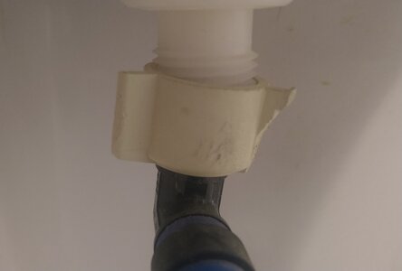

Thank you for the breakdown. Huge help there. I did get my camera back there like Kevin suggested. I see exactly why it leaks. No valve though. I'll follow the recommendations from both of you. Great input great help. Appreciate your patience in the matter. Learn something everyday if you're not careful.
And that is why you use a flexible hook up hose!
Because the thread is now cross threaded, I would put the hose on the toilet before I put the toilet back on the flange.

I Got the parts I need. I wanted a flex hose with the hand screw on at the toilet, but all my local hardware store was the type with the nut. Hope to get it repaired this afternoon. Thank you guys.
