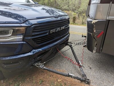

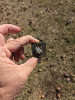

On same trip, my new friend from HOOTs trip had an incident on the way home where his tow bar pivot bolt snapped allowing his Truck Toad to ram into the back of his beautiful Newmar. The emergency cables did their job by not allowing the truck to run away, but the damage was done to both RV and Truck. Thankfully no one was hurt and just put some delay (and cost) into the trip.

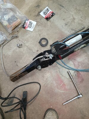

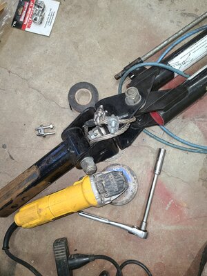

Came up with a stop gap solution. I had some 5/16" stainless steel cable left over from a boat hoist restring. And had two wire retainers for same cable.
Wrapped the clean cut end with electrical tape to keep it from unraveling, and more importantly to keep me from getting poked while wrastling with it.
I made two wraps around the joint. Spread the wire across the available gaps in the brackets so that the wire didn't get in the way of any pivoting.
Since this cable is rated for 9000 lbs of stretch, 2 wraps (4 lines) should be plenty strong enough.
total time invested: 10 minutes. Cost = 0$ (I had the stuff as all packrats do) All stuff available at HomeDepot.
No I don't intend on testing it!!!
More importantly, you might want to inspect your bolts to ensure it's in good health before your next trip. I would buy a spare bolt anyway.
Post updated with Kenny's "Ram" picture and the offending bolt. My hip pocket guess is that is $4K of damage.

I'm the guy David is talking about.
I do have a braking system however, the truck never broke away from the coach so the energy breaking never kicked in.
This happened after coming down an off ramp and turning onto to service road. The bolt broke during the turn and the truck rolled into the coach. We were traveling at low speed at the time due to the turn so the damage was not too bad.
