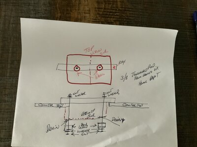

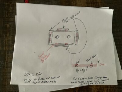

A trick I found was to cut a 2x4 wider then the width of the sink with a hole drilled above the drain, I used a treaded rod with nuts and washers to draw the sink back in place with new sealant

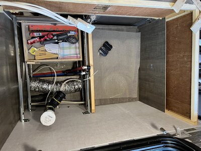

If you lay on your back inside cabinet can you see it
See what? Where would I be looking? There isn't much access to the inside of the cabinet. Most of what I 'see' is by taking my phone and sticking it inside to get pictures.

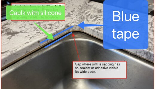

Here is a quick drawing on how to hold sink in place while adhesive sets

When sink is reinstalled caulk between tape lines

the screws on stove side of sink
