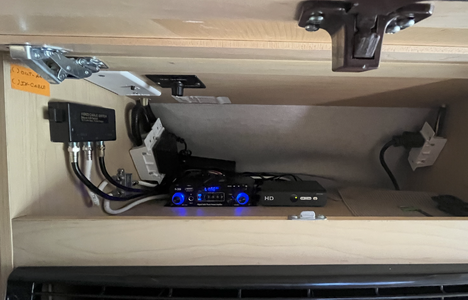

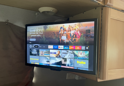

Alright, so my audio guy got back to me on what he is going to install to replace the TV. He also said that the DVD player that is part of the original RT install is what is powering the speakers. He will install a Smart TV. Here is one on Amazon that is dirt cheap and has great reviews. As he says, for this dirt-cheap price, I can replace it down the road for something that might be better. He says that for the size of the TV, the 720p resolution will be fine for Netflix movies. If you prefer, you can go with another smart TV with 1080p resolution, but he says you really won't see the difference on such a small screen. Amazon.com
As for taking out the DVD player that is powering the speakers, he says a small amplifier is sufficient. Here is the one on Amazon that he will install. This is also bluetooth compatible so we can run soundtracks from our iPhones, should we desire. . Amazon.com
Again, for this price, don't expect an audiophile's ecstasy of sound. If you want to upgrade both the TV and the sound amplifier because you want outstanding audio and TV then at least now you have the basis to work with. As for us, we have the upgraded stuff at home but for when we are on the road, we have no need as we will use the TV minimally.
Lastly, if you are trying to run movies from your iPhone/iPad, you need Apple's specific adaptor, not some knock-off. The knock-offs are not compatable with the Apple ecosystem. Here is the one for a USB-C. USB-C Digital AV Multiport Adapter. Apple also has one for a lighting port iPhone/iPad. Best of luck with your replacement/install.

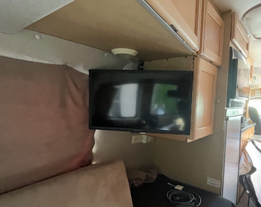

Here is the final result of the installation I had done. Very happy with it.
