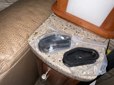

I bought new rubbers from FL on my last visit, but Im still using the old ones. One came out of the wheel slot allowing the valve stem extender to rub and wear through on the edge of the wheel slot, so I replaced the extender and secured the rubber to the wheel with VHB tape. That was several thousand miles ago and they are still firmly in place doing their job so no reason for any changes right now.
I like having a pair of spare rubbers in stock, as well as a spare extender, and I inspect the rubbers and extenders every time I stop, but thats a lot easier than trying to air up an inner without the extenders.

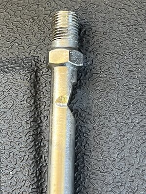

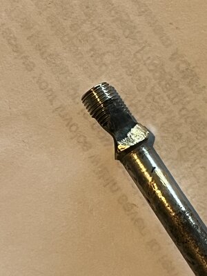

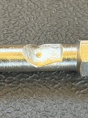

+1 for duallyvalve. I ordered them and went to a truck tire shop who charged me a reasonable amount to install them. Solid one piece steel inner valve that extends all the way out through the outer wheel and has a donut to stabilize it. Frankly I am not surprised at all at FL forcing removal, as they are in a total meltdown on valve extensions, 5 years of recalls now spanning all of their RV chassis models. I fought them for months with physical evidence in hand of the one valve stem extension that I still have that was worn through and ready to fail like its twin did with less than 5000 miles on the chassis. Even though they had tens of thousands of chassis VINs in their recall database, they would not include mine in the recall and accused me of removing their safety equipment from my RV. I have bought my one and only FL product given how they chose to handle my situation.

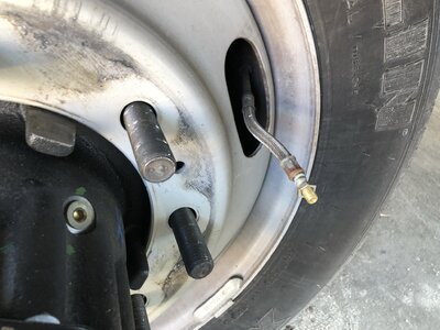

These are the aftermarket extensions we used for years prior to going to solid brass valve stems
Thanks Joe. And I used something similar on my old 2007 gasser back in the day, but I am not sure what to use on these aluminum rims…and even less so on how I would install them. I am not really equipped to pull off the outer dually.

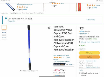

Yes internal sensors, require a special tool to remove valve caps and a long, straight inflator
