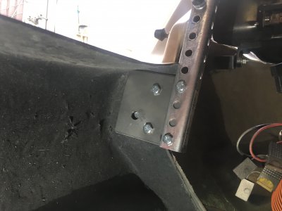

Have a 2016 Ventana LE 4037. The hood for the generator is heavy and hard to hold open while under it to access the prop rod and get it in the hole.
Has anyone installed gas struts to on the hood to solve this issue? If so would appreciate you sharing what you did.
TIA
Some have done this on Dutch Stars and I think Newmar now uses them on some as a result. @Dutch Star Don was the pioneer of this effort I believe. It is possible but will require some engineering. Fortunately we rarely need to be in there.
Did this mod a couple of years ago using dutchstardon’s directions. One of the better mods to be done in my opinion.
@J&JD - How did you determine length of strut to use?
