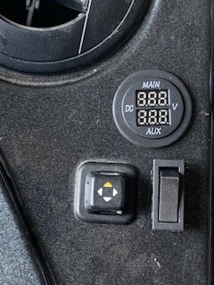

While it is normal to have some fluctuation that seems a bit extreme for that period of time. On thing I did was added a separate small gauge that allows me to monitor both my house and chassis batteries separate from the main energy management system. I did this to be able to monitor both especially when boondocking. Because the green LEDs are quite bright I did add a switch so it does not have to be on all the time.
