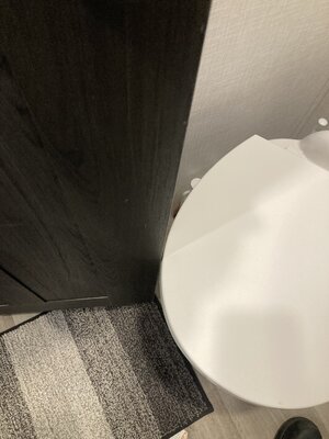

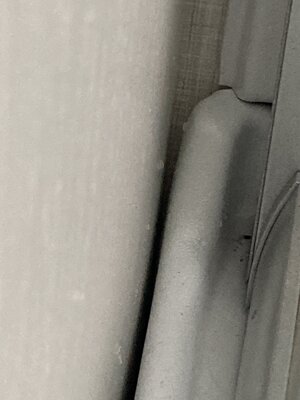

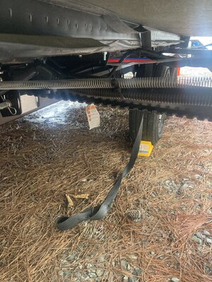

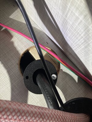

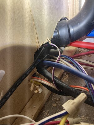

Venture factory quality control is horrible….. see photo of things that should have never left the factory!Bathroom door leading to bedroom blocked by toilet. Shower doors leak water, particularly in areas you can’t reach to clean up.Holes over cut for grommets and just screwed with 1 screw,electrical wires pulled so tight they ripped into the wood,RV not even a year old used for 4 trips and slide seal tore..the list goes on.
Be sure to go through your RV with a fine tooth comb, and pay a private inspection service before signing anything, and have the dealer remove every access panel so you can see what’s hiding behind them.Dont buy any additional warranties because getting the work done is like pulling teeth.
