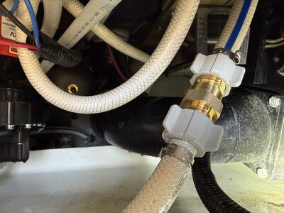

In the above picture, the white hose. Does anyone know the ID/OD of that fresh water hose line?

At my new location, all is working great with the new water pump and it's starting to sound more like the AES pump with the lower rumble water pump noise. I swore I'd leave it alone as I'm cutting this trip short and deal with it when in storage or a later date. Well, we know I can't do that and the weather here in Charlotte is very nice today. So I decide let's get the Valterra check valve put inline just prior to the pump to ensure water does not flow backwards through the house filters and rely on the presumably failed check valve at the city water side of the filters.
Cut the hose, inserted the check valve and used pex cinch clamps to give a perfect seal to the lines using my pex cinch clamp tool which has really come in handy at times for quality plumbing work.
IMG_6702.JPG​
I then decided to try the accumulator tank again so I put that inline as I am getting water cycling in the master bath faucet and hence why I installed the accumulator tank to fix that, and it does. I did a leak check and sure enough I had a leak at the water pump inlet filter basket with the plastic cover not on secure enough so I may have been drawing air previously, so in the end, glad I did this today. Super simple and leak check is good at all connections and water pump tests good, doing laundry now.
Case closed. Please stop me from doing mods! But hey, this one solved a problem and was good learning. Higher flow pump and accumulator tank to prevent lower pressure draws from cycling the pump.
