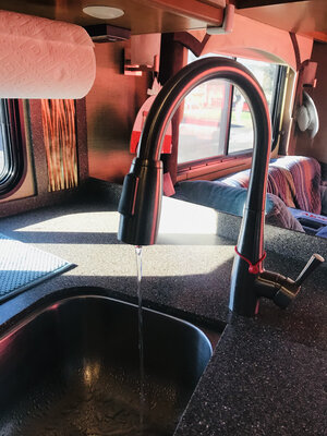

Yes I have cleaned the screens. The shower has always worked well the bathroom faucet is acceptable, But the kitchen faucet output is not as big as a pencil. any ideas?

Always like this or recent problem? Same with water pump ON vs. city water? If you have AutoFill and it's enabled, is it currently filling? If so, try the water pump ON.
I've seen the seals in those types of faucets swell and restrict flow or a chunk of it is lodged in the feed tube to the head. The quick connect has a small orifice that may catch a piece of rubber from the seal. Does the handle move freely? I had calcium build-up in my shower mixing valve (on the hot side) when I first bought mine. Brrrrrr

This has the same flow from either the hot or cold? If it is the same for both hot and cold then the problem is in something common between the two. Pull the valve assembly apart and check for debris in the holes and also check in the ball too.

Check your supply lines for a clog. With the spray faucets, it doesn't take much to clog them. I've have to tear ours down to blow out the tiniest of dirt particles.
Get a bucket and pull the supply line off the faucet. Point the supply line into the bucket and have someone turn on the water pump and see what the flow is.

I know this is no help, but I just have to tell you about our kitchen faucet that didn't work when we brought our new RV home. All the faucets worked fine except for the kitchen. I would push it one direction for hot- nothing. Push it in the direction of cold- nothing. Trouble shot everything possible and still nothing. Was on the phone with the dealer for I don't know how long. FINALLY- I think by accident- I pushed the handle sideways and guess what?!? It worked. Just like yours looks like in the picture. Jeez. Sometimes wonder how I survive in the real world.....
Oh yeah- we have the exact same fixture. If everything is working right, the heighth of the stem shouldn't matter.
